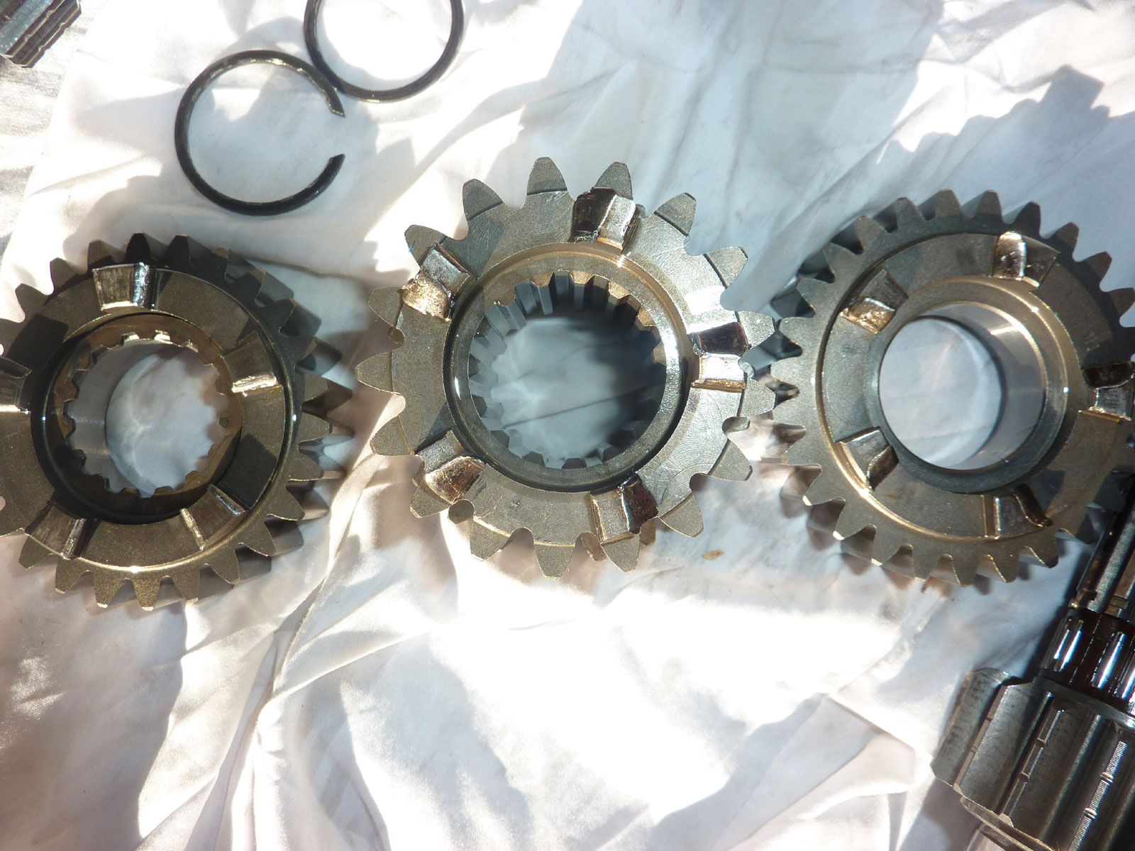

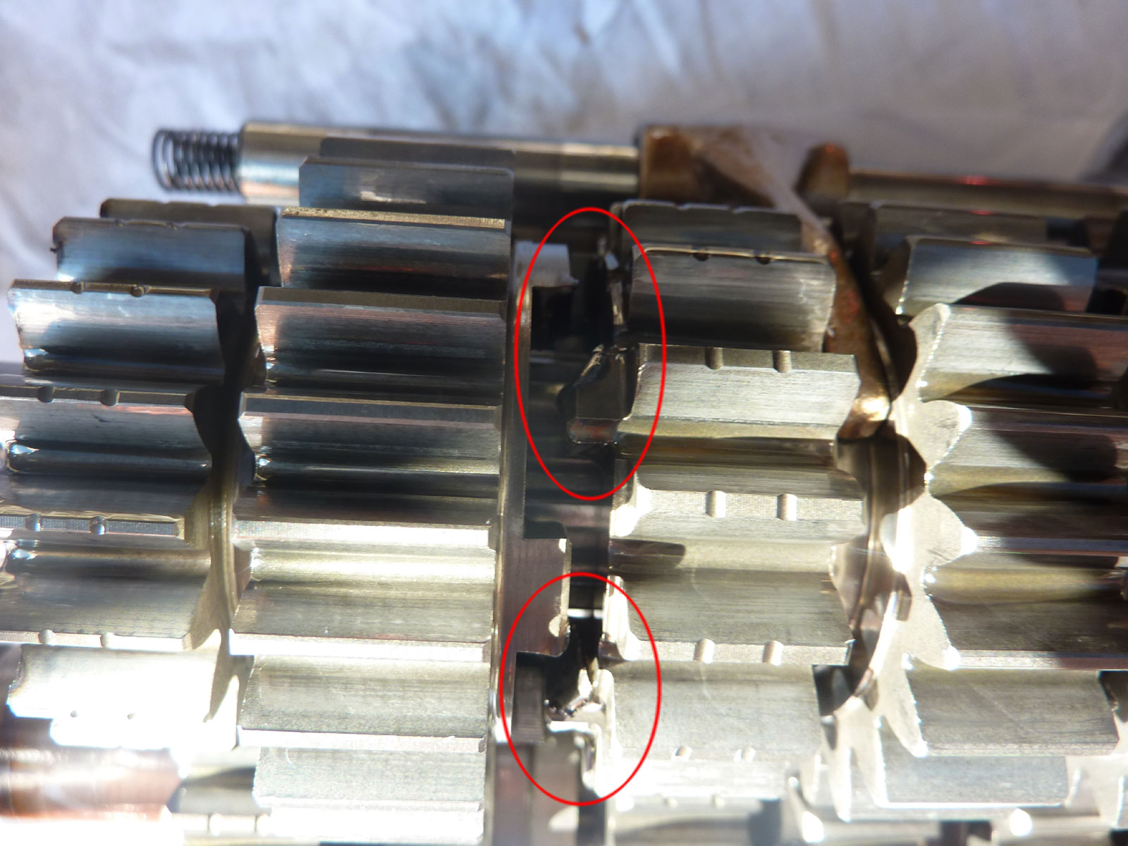

    So the Ape has been dramatically dropping out of 6th gear (so much so that I've been restricted to only using 5th gear). It just griiiiiinds in no gear, even with the clutch in, until I slow down enough to finally find a lower gear. It also found a false neutral a couple of times on the change upward from 3rd to 4th. So out came the gearbox today.
    When I had a look, it's missing the circlip that holds the final pinion gear (2nd) on the primary shaft, which meant that the teeth between 6th and 3rd were not held together, and also to a lesser extent between 5th and 4th. Check out the wear, particularly on 6th.
    Oh, and you gotta love cassette gearboxes!! Soooo easy to work on. Anyone would think they designed this bike with racing in mind

    I have been wondering exactly that, Steve. I haven't found it yet; access isn't great, but I haven't really looked hard yet. Might have to unbolt the sump.
    Ed, yep, new individual gears are on order now. They are pretty cheap too.

    Hey marshy.. I think have heard a little about this happening.. Some guys saying the first sign of it happening is excessive play in the gearlever at the countershaft? Guys saying they were getting up to 10mm play either direction before it selecting instead of about about 1-2mm.. Mines got about 6-8mm and have been worried about it for a few months now.. U didn't happen to notice any play on yours prior did u?? Also have missed 3-4 a couple times the other week. But no grinding noises
  17. #17
    That now makes total sense. I had MASSIVE amounts of travel on the gear lever. Like, so much that with my busted foot, I couldn't get it into a position where I had enough throw with my foot to upshift and downshift. I didn't measure, but I'd guess a lot more than 10mm in either direction. Never having ridden an Ape before, I assumed it was a design thing, and I just manually shortened the amount of throw.
    Missing 3-4 is kind of a 'known issue' from some of the reading I've been doing. It happens fairly regularly, and I think you just change them out.
    I only got the grinding stuff when it fell out of 6th (ie every time through turn 1 at the Creek, until I gave up and left it in 5th). Missing the 3-4 shift just sent the engine bouncing off the limiter at full throttle, until I could grab a gear again.
    I'd suggest you'll have the same issue then. It probably won't do that much more damage than is already there, unless the circlip ends up somewhere it shouldn't.... Everything will already need replacing.

    Easy. They mostly just slide off, except you also need to remove a couple of circlips to get them all off. 5 minute job.

    do the circlips come off with circlip pliers or is some other special tool required?
    They are easy enough to lever off with a small flat-blade screwdriver. My terminology is probably a bit out.... I suspect they aren't proper circlips, as they don't need circlip pliers and they don't reach 99% of the way around. I guess they have another proper name, but IDK what it is.
    It's all surprisingly easy when you get into it. Do you have a copy of the workshop manual, just in case?
  42. #42
    Quote Originally Posted by Marshy View Post
    Yep, ive got the workshop manual. Ill give it a go I guess the hardest bit is most likely putting the clutch cover back on!
    Gotta be able to do this stuff yourself at the track so its a good time to learn....

    Well, I just finished reassembling the new gearbox. It's back in the bike, and once I sand down the clutch plates and put the clutch back in, it'll be ready to fire up for the first time. That's tomorrow's task.
